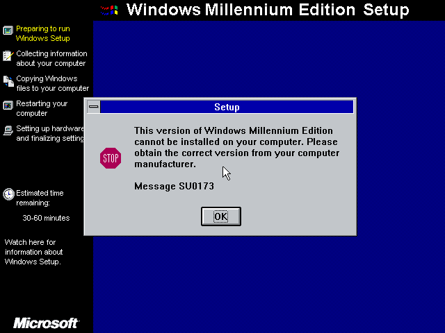

Windows 9x discs are actually sometimes OEM-locked, typically via the manufacturer string in the BIOS. my Dell OEM copy of Windows Me will only install on Dell machines, even though it's a normal Windows install disc in all other regards. and since my singular Dell machine is far too new to run Me (Core 2 Duo from like 2011), the disc is basically useless to me lol
meanwhile, my Dell Windows XP disc will install on anything without issues. the only real difference is that on non-Dell machines, it doesn't apply the few Dell-specific tweaks, like the extra Help & Support menu and what looks like a registry tweak for something USB related? not quite sure what it is just looking at it, but you get the idea
here's a picture of the warning said Windows Me disc spits out on a non-Dell machine

Interesting, I did not know that. I've never bothered much with 9x in general so I probably would have never found that out if you had not mentioned it

Same, I knew that OEM boot disks were oftentimes hardware locked just by virtue of the weirdness of CD-ROM drivers and the like under DOS, but I never realized that 9x OEM discs themselves were sometimes hardware locked.
