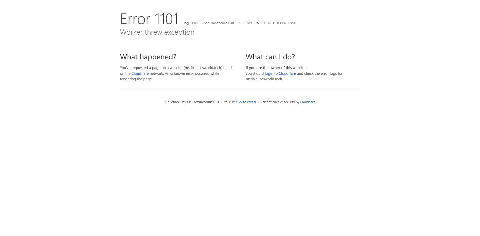

** msdn.alicesworld.tech appears dead currently, and has been for a while. I'll just leave the link there in case it comes back.
