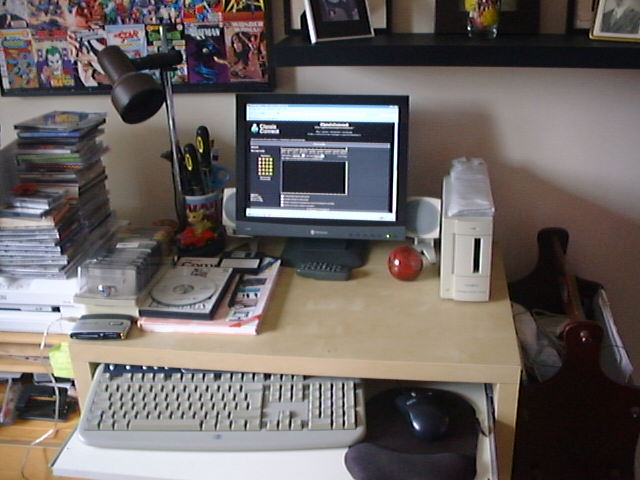

I'm not too sure if anyone is keeping up with this, but I've finally got the system working... after some duff DVD-ROM drives, and a dead couple of RAM modules (now breezing along with 64MB PC100).
Anyway, I'm typing this message from my P3 system. Sound drivers I'm yet to sort out for the SB Live! but I've got everything else set up and working. Finally! Shocked
The beige case on the right in the first photo is my old one from when I rehoused the system. I think I've sourced it a new home with a friend of mine, to avoid it seeing the bin! Exclamation
