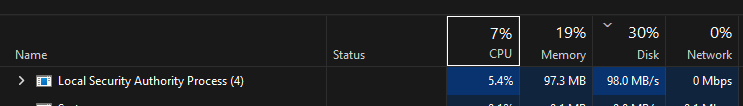

So after a while of using the above method, it turns out there is another bug that needs to be dealt with. So, on Windows 10 and 11, specifically on older domains, you will find issues with Credential Manager. On Windows 10, this simply caused some applications to fail to log in (or would lose your login credentials upon reboot).
On Windows 11, this causes a whole host of issues other than the aforementioned credential issues. Now it causes not only random lag spikes and freezes, but also spams the shit out of your SSD!
I was getting constant 100MB/s of writes to my SSD:
This caused the total host writes to my SSD to balloon in 4 days to 39TB!
It's honestly insane that a credential manager bug could cause a constant flood of writes to disk. No failed process should cause this kind of damage...
