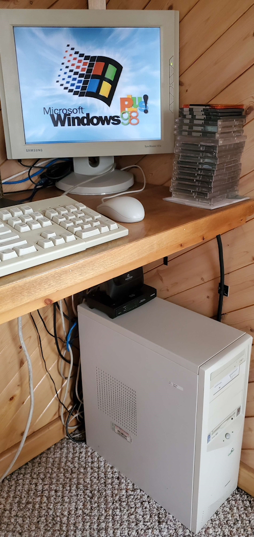

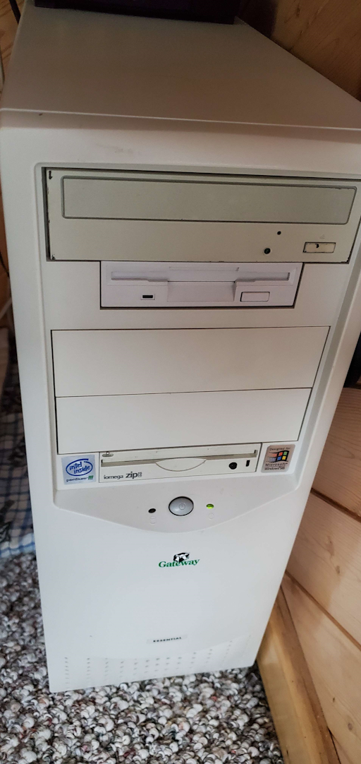

Here is my restored Gateway Essential 450! I got it from a friend who's parents had it in their office in a desk cabinet they haven't touched in ages. When he went to pick it up, IT WAS STILL ON. He was going to toss it but I said I'd take it. I got it home, cleaned it up and ran a test on it. The drive was dead, click of death. I put in a SATA drive using an IDE to SATA adapter and started adding operating systems. I then added cards to it. Hardware specs and parts I've added below.
Pentium III @ 450MHz
768 MB of RAM
ATI Rage 128 Pro 4XL
Aureal Vortex with Soundblaster Pro emulation
DAVICOM 9102/A PCI Fast Ethernet Adapter
500GB SATA HDD (I'm using an IDE to SATA adapter)
CD/DVD Drive
Floppy Drive
Iomega ZIP-100 Drive
IBM KB-7953 Keyboard and Logitech M-BE58 Pilot Wheel Mouse
Samsung SyncMaster 151s Flat Panel Monitor
DOS 5.00, Windows 98 SE, and Windows XP (I use Acronis as my boot manager)

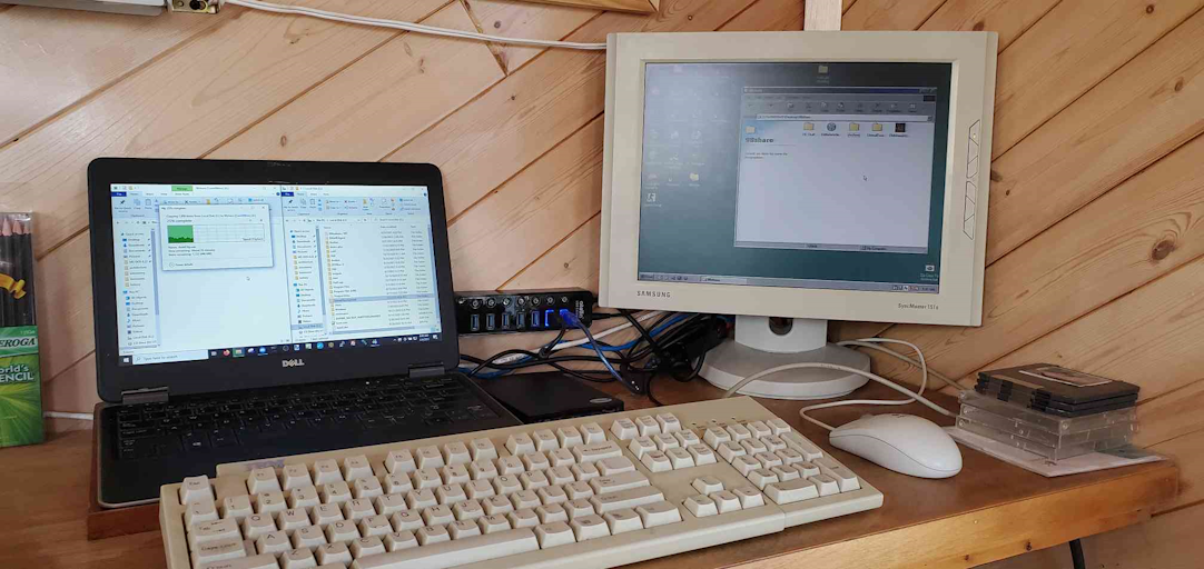

I use a VGA splitter with a USB VGA Capture device to stream my retro PC and record videos. The laptop there is transferring files to a shared drive on the Gateway.

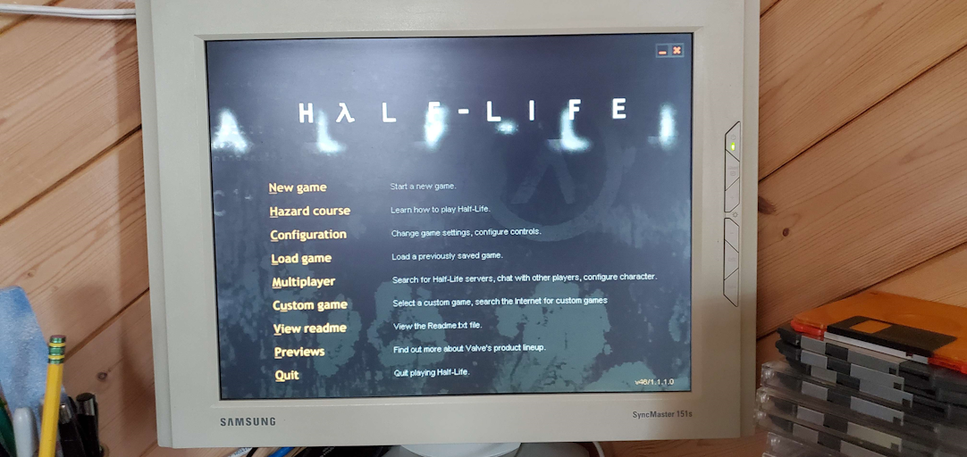

And of course you can't have a Windows 98 machine without Half-Life!
