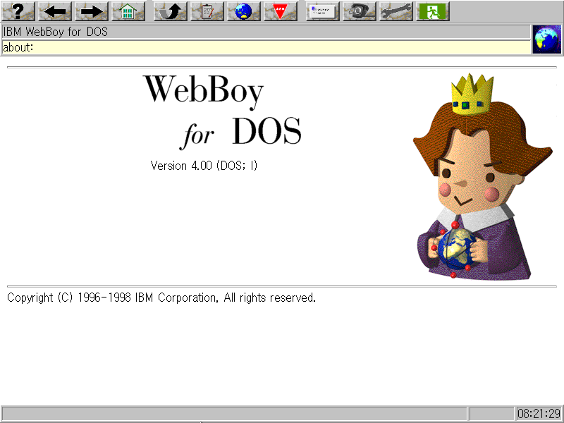

IBM WebBoy for DOS is.. interesting. it's an entirely DOS based browser and e-mail client for Japanese DOS systems, seemingly designed specially for the Palmtop PC 110 (although will run on standard PCs of course). i found it while scrolling on archive.org, and immediately knew i had to try it. getting it actually set up kind of SUCKED, though. a combination of the language barrier as well as using a minimal copy of Microsoft LAN Manager in the backend(?????) which i haven't used myself made it difficult to actually get it functioning initially.
screenshots (or screenies if you fancy):
screenshot of the built-in about page for WebBoy 4.0

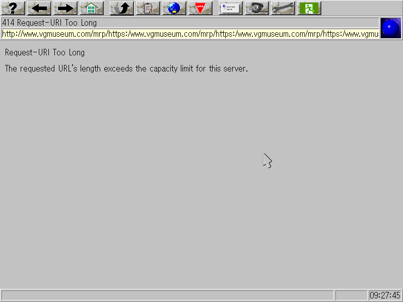

screenshot of lesliefield.com (ironically this site made the entire machine lock up after trying to enter)

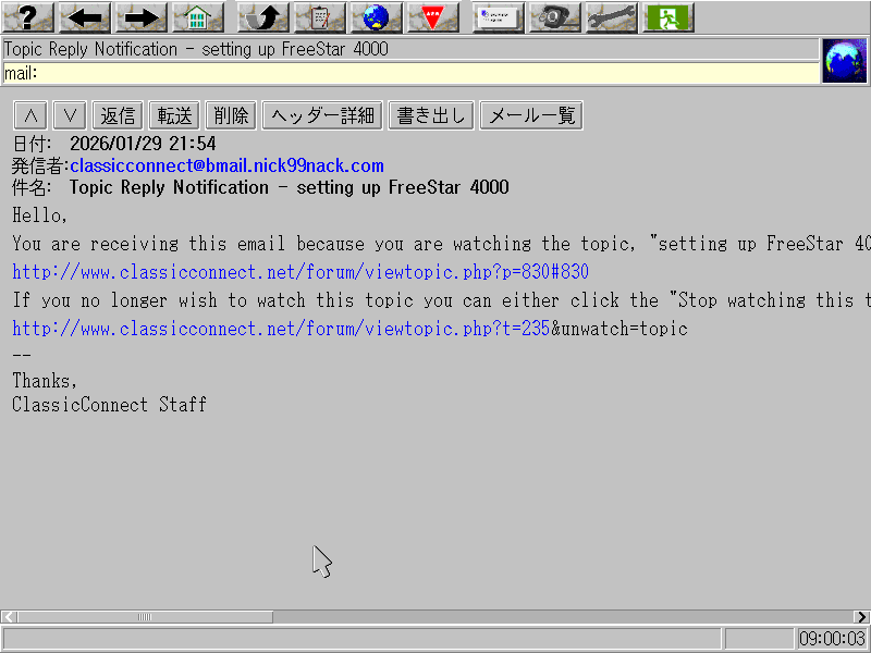

screenshot of a ClassicConnect reply notification email

- https isn't even recognized as a valid protocol, so it tries to append it to the end of the current url as if it was a relative page link (i.e http://wiby.org/surprise/https://www.vgmuseum.com)
- if the site itself redirects to https, it also gets confused and keeps appending the link to the end over and over

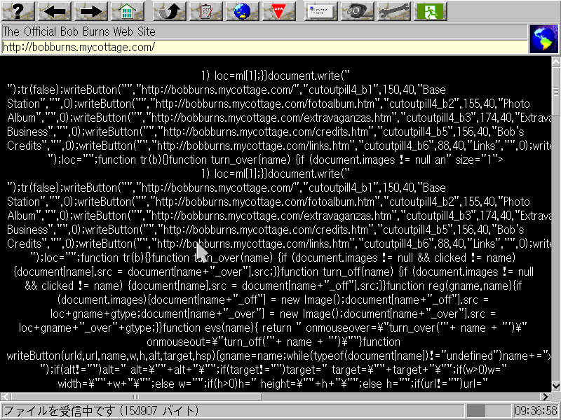

- it loves vomiting JavaScript all over the screen if the site has any and it doesn't know how to handle it (turning it off entirely seems to fix it though)
"my boy;; he has the sickly" - me after first discovering this bug
